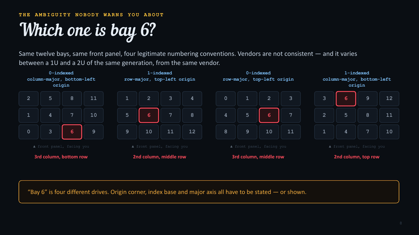

Which one is bay 6?
Here is the ambiguity nobody warns you about. Same twelve bays, same front panel, four legitimate numbering conventions.
"Bay 6" is four different drives. Origin corner, index base and major axis all have to be stated, or shown.
Vendors are not consistent, and it varies between a 1U and a 2U of the same generation from the same vendor. On one 24-bay chassis I work with, the front bank enumerates 0 through 11 column-major from the bottom left, and nothing about the chassis tells you that. Confirm the convention with a locator-LED pass on one node before a per-bay sheet goes out.

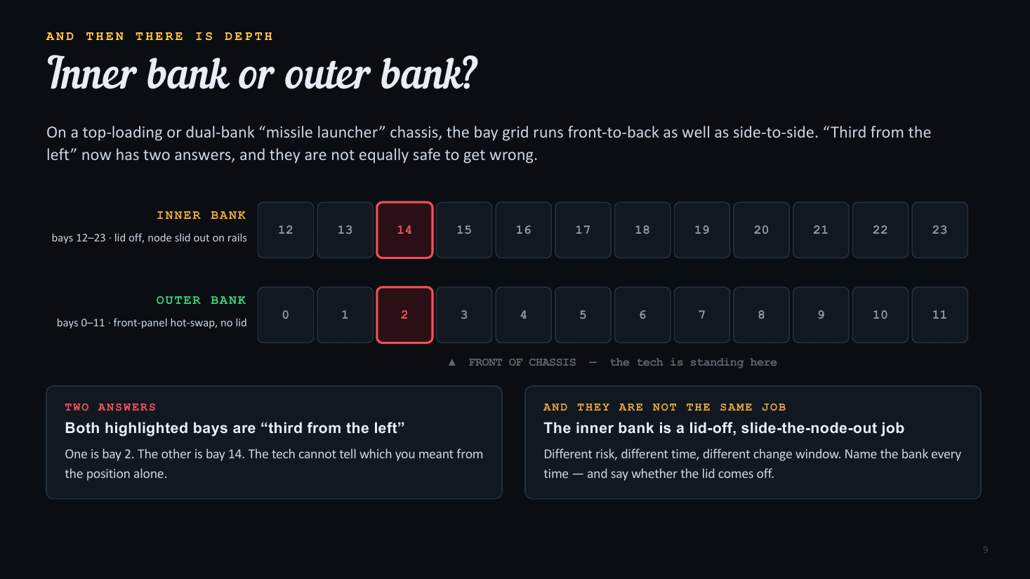

And then there is depth
On a top-loading or dual-bank "missile launcher" chassis, the bay grid runs front to back as well as side to side. "Third from the left" now has two answers, and they are not equally safe to get wrong.
Both highlighted bays are "third from the left." One is bay 2; the other is bay 14.
The outer bank is front-panel hot-swap. The inner bank is a lid-off, slide-the-node-out job: different risk, different time, different change window. Name the bank every time, and say whether the lid comes off.

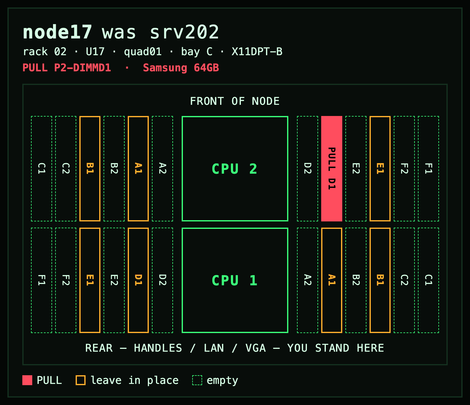

In practice: memory
Show the board, not the slot name. Draw the DIMM slots where they physically are, relative to the front of the chassis and to the CPU sockets, and then label them.
One red cell. Everything else is orientation.
  • Orientation. State which way they are standing: "FRONT OF NODE" up top, "REAR, YOU STAND HERE" below.
  • Landmarks. Both CPU sockets drawn in place, in their real positions and at their real size.
  • Slot names. P2-DIMMD1 on the cell itself: verification now, and repetition that teaches the scheme.
At a typical 8-of-24 population, every pull reduces to something like "CPU 2, left bank, the inner one of the pair," which is executable with no labels at all. Say that in chat alongside the card.

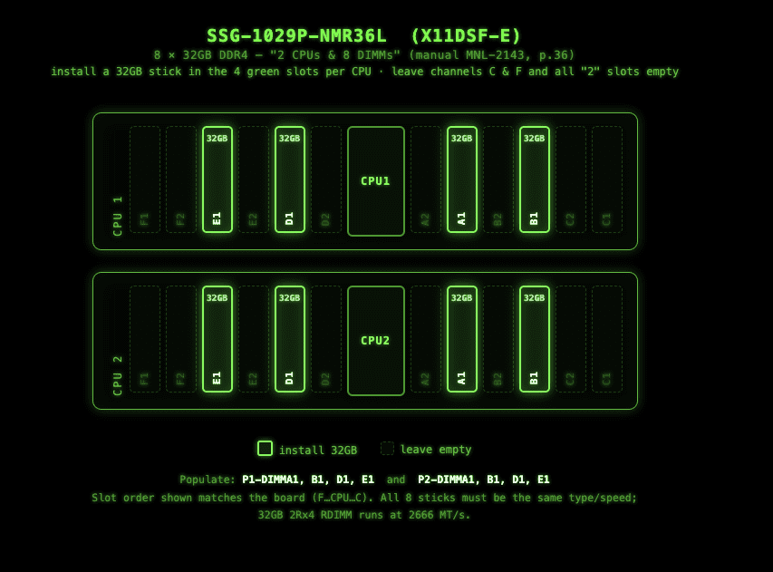

A population plan is the same drawing with the action inverted: fill these, leave those empty. Channel rules are decisions the tech should never have to make at the rack.
One action per cell, the population rule stated as an outcome, and the manual page it came from.
Every generated card should name the manual and page it came from, so a wrong layout is catchable.

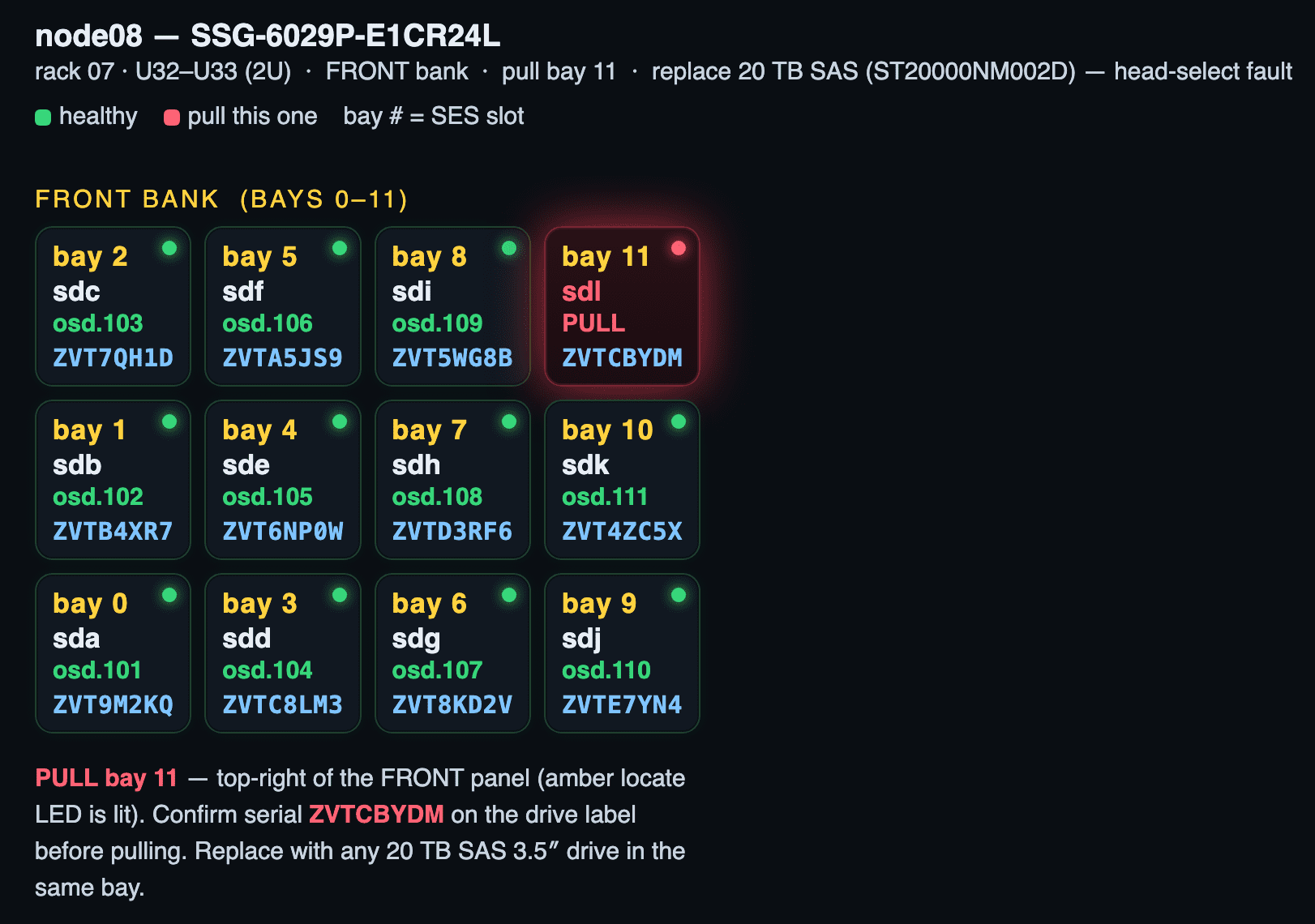

In practice: drives
Same treatment for drives: the real grid shape, in the real orientation, with the one bay in question highlighted and everything else visibly not-it.
Light up the bay, not the sentence.
  • One highlight. Eleven calm cells and one red one. The eye finds it first.
  • Position in words too. "Top-right of the front panel" catches the case where the picture printed in grayscale.
  • The read-back. The grid finds the drive; the serial on the label proves it. Confirm the serial before pulling.

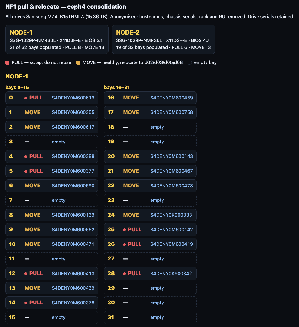

Red means scrap
A single fault is the easy case. A real job often has two actions at once, and in this one the difference between them is fourteen drives going in the bin and twenty-six good ones going back into service.
One of two nodes from a real consolidation. Drive serials kept so the tech can confirm; hostnames, chassis serials, rack and RU stripped.
Reserve the red. Red is "this part is bad," and nothing else. Amber is "healthy, and moving." Color those the same and twenty-six working 15 TB drives go in the scrap bin. Say the action, not the state: a healthy drive being relocated is not FAILED.
Enumerate every pull by bay, never by count and never by model. Hands cannot see what is in a bay before they pull it, so "pull any 8" is not executable. Eight bay numbers are.

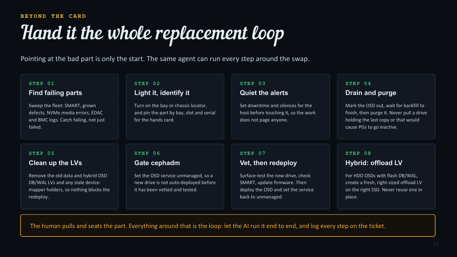

Hand it the whole replacement loop
Pointing at the bad part is only the start. The same agent can run every step around the swap:
  1. Find failing parts. Sweep the fleet: SMART, grown defects, NVMe media errors, EDAC and BMC logs. Catch failing, not just failed.
  2. Light it, identify it. Turn on the bay or chassis locator, and pin the part by bay, slot and serial for the hands card.
  3. Quiet the alerts. Set downtime and silences for the host before touching it, so the work does not page anyone.
  4. Drain and purge. Mark the OSD out, wait for backfill to finish, then purge it. Never pull a drive holding the last copy, or one whose removal would cause PGs to go inactive.
  5. Clean up the LVs. Remove the old data LV, the DB/WAL LV of a hybrid OSD, and any stale device-mapper holders, so nothing blocks the redeploy.
  6. Gate cephadm. Set the OSD service unmanaged, so a new drive is not auto-deployed before it has been vetted and tested.
  7. Vet, then redeploy. Surface-test the new drive, check SMART, update firmware. Then deploy the OSD and set the service back to unmanaged.
  8. Hybrid: offload LV. For HDD OSDs with flash DB/WAL, create a fresh, right-sized offload LV on the right SSD. Never reuse one in place.
The human pulls and seats the part. Everything around that is the loop.
A recent example: an OSD was crash-looping on a 16 TB HDD that had grown hundreds of defects. The agent silenced the alerts, purged the OSD, freed its DB LV, lit the slot, and gated the OSD spec. When the replacement went in, it wiped and surface-tested the drive and updated its firmware, then deployed the new OSD with a fresh DB LV on the shared SSD. The human only touched the drive. Let the AI run the loop end to end, and log every step on the ticket.

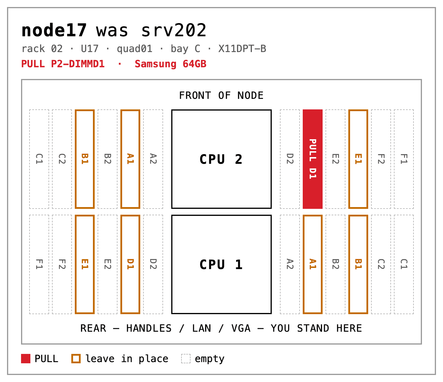

Put an all-in-one printer in the datacenter
This is the unglamorous one, and the cheapest item in the whole workflow. It is also the one people leave out. Put a printer in the datacenter, even if the techs have to reach it over Bluetooth or the printer's own Wi-Fi.
The same card in a print theme: white ground, one filled cell. Black backgrounds cost a fortune in ink.
  • Hands full. Paper is easier to carry than a phone. It goes in a pocket, under an arm, or on top of the chassis, and it does not lock, sleep, or need a clean finger.
  • No scrolling. Few people have an 8½ × 11 phone. On paper the grid, the slot list and the confirmation note are in view together, which is exactly when a tech catches a mismatch.
  • Offline by default. The one artifact that does not care whether the cage Wi-Fi is up. Print before they walk in, with a datestamp in big friendly red letters at the top of each page.
It earns its keep the rest of the time too: RMA paperwork, packing slips and shipping labels are all best printed on site anyway, which is what gets it approved on the expense line.
