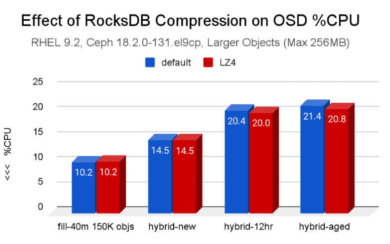

The primary and most surprising finding from our tests is that enabling RocksDB compression had no negative impact on performance. The specific algorithm used was LZ4, a lightweight solution known for its high speed. Our analysis suggests that modern CPUs are so efficient at processing algorithms like LZ4 that the overhead is negligible, particularly when compression operations occur on the high-speed NVMe devices where the RocksDB database resides.

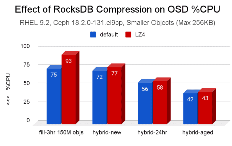

Across a variety of hybrid workloads (45% reads, 35% writes, 15% stats, and 5% deletes), we observed no detrimental effect on throughput or CPU resource consumption compared to running the same workloads without compression. This effectively eliminates the traditional trade-off.
Graph 1. CPU Consumption for Small Objects
![](images/7a80e345-6972-4b18-9c05-860c5a64ab05.png align="center")
Graph 2. CPU Consumption for Large Objects

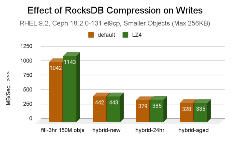

Graph 3. Throughput for Small Object Writes
![](images/a588ee07-7f0c-4903-a8ab-3b11f0f543d8.png align="center")

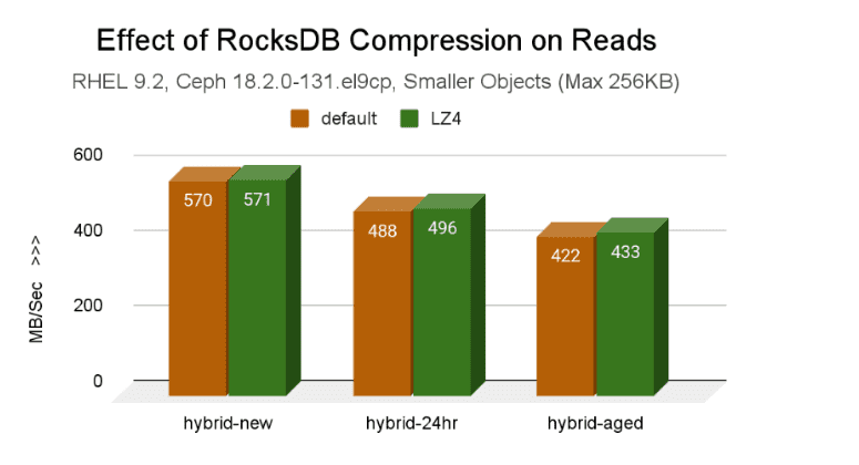

Graph 4. Throughput for Small Object Reads

The results confirm that using RocksDB compression has no detrimental effect on either throughput or resource consumption in Ceph, while providing significant savings in DB space (compression ratio), especially for smaller objects. This allows a smaller WAL+DB offload partition for each OSD, or conversely helps avoid spillover of RocksDB level data onto the BlueStore slow device.

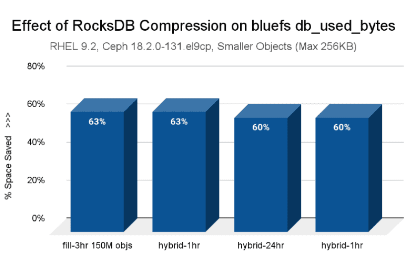

While compression proved beneficial across the board, its impact was most dramatic on small-object workloads. Our tests, which used object sizes ranging from 1 KiB to 256 KiB, showed a remarkable reduction in the storage required for RocksDB metadata. In a BlueStore configuration, Ceph's internal metadata is managed by a RocksDB database running on top of the BlueFS file system on a fast storage device, in our case, an NVMe SSD.

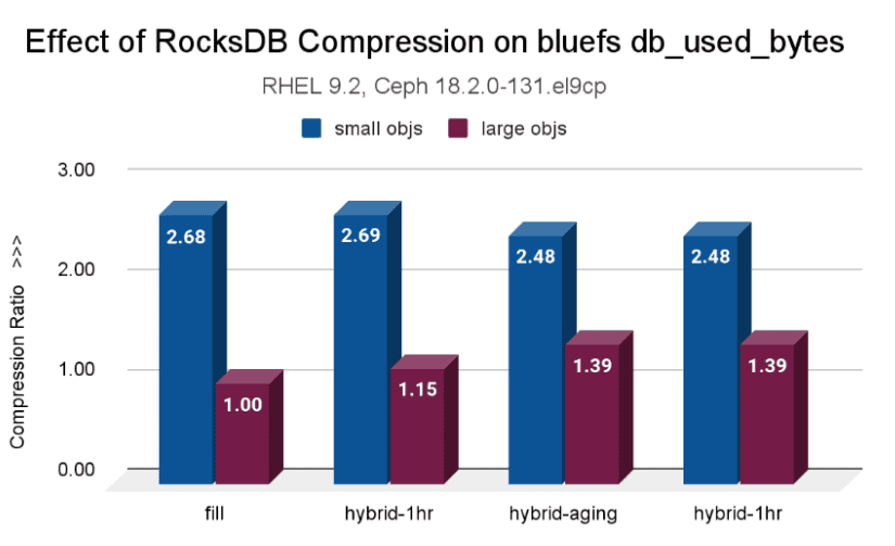

The single most impactful data point we recorded was this: with compression enabled, the bluefs db_used_bytes workload for small objects required 2.68 times less storage during the cluster fill. This is a massive efficiency gain. For any organization whose workload involves storing millions or even billions of tiny objects, the metadata overhead can become a significant storage burden. This feature directly and powerfully addresses that specific pain point by compressing the metadata database on the fast offload device, not object data on HDDs.
This is particularly critical for Object Storage (RGW) workloads. When using the Ceph Object Gateway (RGW), all rich metadata associated with an object, such as its name, size, ACLs, and custom user tags, is stored in RocksDB instances spread across the OSDs that comprise the index pool. Furthermore, the bucket index, which lists all objects within a bucket, is maintained as omap entries in this same database.
For clusters with millions or billions of small objects, this metadata and index data can swell to consume terabytes of space, often becoming the primary capacity bottleneck on the expensive, high-speed NVMe drives. Compressing RocksDB directly compresses this RGW metadata, providing massive and immediate relief on that fast tier.

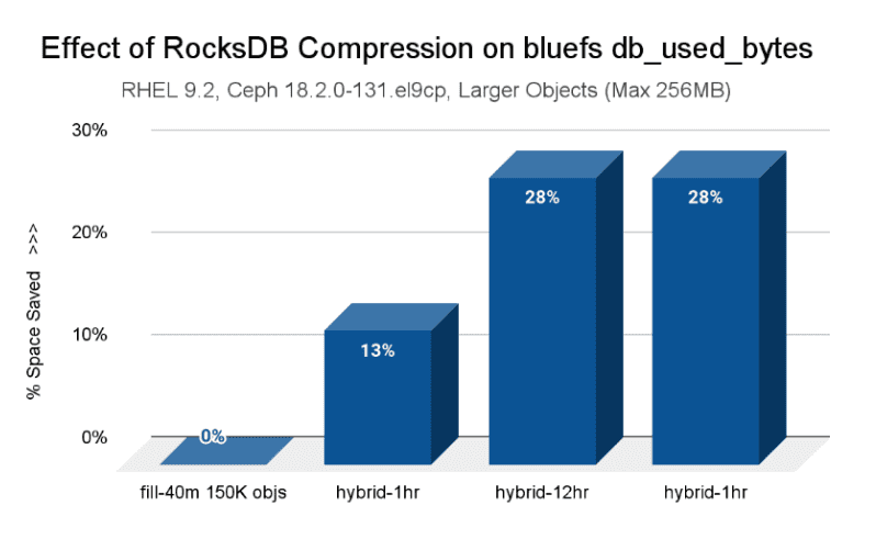

It's Not Just for Small Objects: Large Objects Also See a Clear Benefit
The positive effects were not limited to small objects. Our tests on large-object workloads, ranging from 1 MiB to 256 MiB, also showed clear benefits. While the source report highlights the most dramatic space savings for small objects, it explicitly notes that the positive effect across both sets of object sizes is evident, making compression a clear win for large-object workloads as well.
![](images/94f71417-270f-4009-8e87-37c762dcf998.png align="center")

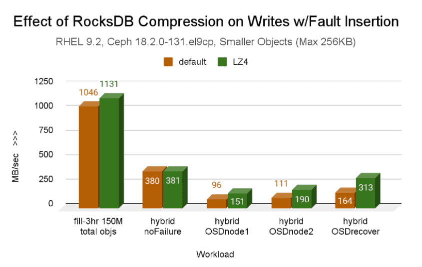

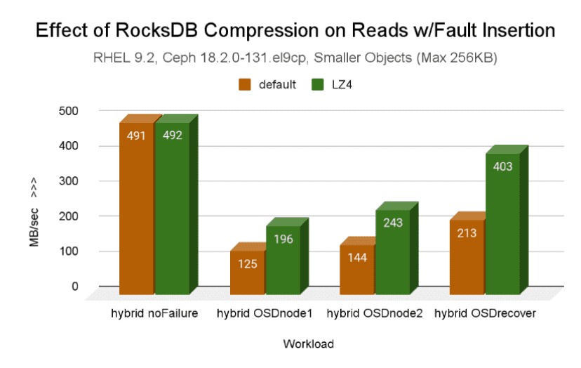

Furthermore, our test plan included stressful OSD failure scenarios to measure behavior under duress. The overall conclusion of "no detrimental effect" on performance or resource consumption held even during these fault and recovery operations. This implies that RocksDB compression is not just efficient but also a stable and robust feature under pressure.
Graph 5. Throughput for Small Object Reads During Failure

Graph 6. Throughput for Small Object Writes During Failure
