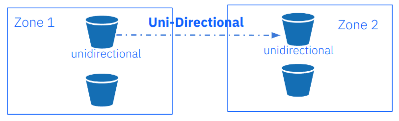

Unidirectional Bucket Sync ¶
In the previous article, we explored a bucket sync policy with a bidirectional configuration. Now let’s explore an example of how to enable unidirectional sync between two buckets. Again to give a bit of context, we currently have our zonegroup sync policy set to allowed, and a bidirectional flow configured at the zonegroup level. With the zonegroup sync policy allowing us to configure replication at per-bucket granularity, we can start with our unidirectional replication configuration.
We create the unidirectional bucket, then create a sync group with the id unidirectional-1, then set the status to Enabled. When we set the status of the sync group policy to enabled, replication will begin once the pipe has been applied to the bucket.
[root@ceph-node-00 ~]# aws  --endpoint https://object.s3.zone1.dan.ceph.blue:443 s3 mb s3://unidirectional
make_bucket: unidirectional
[root@ceph-node-00 ~]# radosgw-admin sync group create --bucket=unidirectional --group-id=unidirectiona-1 --status=enabled
Once the sync group is in place, we need to create a pipe for our bucket. In this example, we specify the source and destination zones: the source will be zone1 and the destination zone2. In this way, we create a unidirectional replication pipe for bucket unidirectional with data replicated only in one direction: zone1 —> zone2.
[root@ceph-node-00 ~]# radosgw-admin sync group pipe create --bucket=unidirectional --group-id=unidirectiona-1 --pipe-id=test-pipe1 --source-zones='zone1' --dest-zones='zone2'
With sync info, we can check the flow of bucket replication. You can see that the sources field is empty as we are running the command from a node in zone1, and we are not receiving data from an external source. After all, from the zone where we are running the command, we are doing unidirectional replication, so we are sending data to a destination. We can see that the source is zone1, and the destination is zone2 for the unidirectional bucket.
[root@ceph-node-00 ~]# radosgw-admin sync info --bucket unidirectional
    "sources": [],
    "dests": [
            "id": "test-pipe1",
            "source": {
                "zone": "zone1",
                "bucket": "unidirectional:89c43fae-cd94-4f93-b21c-76cd1a64788d.34955.1"
            "dest": {
                "zone": "zone2",
When we run the same command in zone2, we see the same information but the sources field show receiving data from zone1. The unidirectional bucket zone2 is not sending out any replication data, which is why the destination field is empty in the output of the sync info command.
[root@ceph-node-04 ~]#  radosgw-admin sync info --bucket unidirectional
    "sources": [
            "id": "test-pipe1",
            "source": {
                "zone": "zone1",
                "bucket": "unidirectional:66df8c0a-c67d-4bd7-9975-bc02a549f13e.36430.1"
            "dest": {
                "zone": "zone2",
    "dests": [],
Once we have our configuration ready for action, let’s do some checking to see that everything is working as expected. Let’s PUT three files to zone1:
[root@ceph-node-00 ~]# for i [1..3] do ; in aws --endpoint https://object.s3.zone1.dan.ceph.blue:443 s3 cp   /etc/hosts s3://unidirectional/fil${i}
upload: ../etc/hosts to s3://unidirectional/fil1
upload: ../etc/hosts to s3://unidirectional/fil2
upload: ../etc/hosts to s3://unidirectional/fil3
We can check that they have been synced to zone2:
[root@ceph-node-00 ~]# aws --endpoint https://object.s3.zone2.dan.ceph.blue:443 s3 ls s3://unidirectional/
2024-02-02 17:56:09        233 fil1
2024-02-02 17:56:10        233 fil2
2024-02-02 17:56:11        233 fil3
Now let’s check what happens when we PUT an object to zone2. We shouldn’t see the file replicated to zone1, as our replication configuration for the bucket is unidirectional.
[root@ceph-node-00 ~]# aws --endpoint https://object.s3.zone2.dan.ceph.blue:443 s3 cp   /etc/hosts s3://unidirectional/fil4
upload: ../etc/hosts to s3://unidirectional/fil4
2024-02-02 17:57:49        233 fil4
We checked in zone1 after a while and can see that the file is not there, meaning it did not get replicated from zone2 as expected.
[root@ceph-node-00 ~]# aws --endpoint https://object.s3.zone1.dan.ceph.blue:443 s3 ls s3://unidirectional

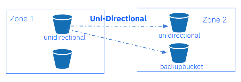

In this example we are going to modify the previous unidirectional sync policy by adding a new replication target bucket named backupbucket. Once we set the sync policy, every object uploaded to bucket unidirectional in zone1 will be replicated to buckets unidirectional and backupbucket in zone2.
To get started, let's create the bucket backupbucket:
[root@ceph-node-00 ~]# aws  --endpoint https://object.s3.zone2.dan.ceph.blue:443 s3 mb s3://backupbucket
make_bucket: backupbucket
We will add a new pipe to our existing sync group policy named backupbucket. We created the group sync policy in our previous unidirectional example.
Again, we specify the source and destination zones, so our sync will be unidirectional. The main difference is that now we are specifying a destination bucket named backupbucket with the --dest-bucket parameter.
[root@ceph-node-00 ~]# radosgw-admin sync group pipe create --bucket=unidirectional --group-id=unidirectiona-1 --pipe-id=test-pipe2 --source-zones='zone1' --dest-zones='zone2' --dest-bucket=backupbucket
Again, let's check the sync info output, which shows us a representation of the replication flow we have configured. The sources field is empty because in zone1 we are not receiving data from any other source. In destinations we now have two different pipes. The first test-pipe1 we created in our previous example. The second pipe has backupbucket set as the replication destination in zone2.
    "sources": [],
    "dests": [
            "id": "test-pipe1",
            "source": {
                "zone": "zone1",
            "dest": {
                "zone": "zone2",
            "params": {
                "source": {
                    "filter": {
                        "tags": []
                "dest": {},
                "priority": 0,
                "mode": "system",
                "user": "user1"
            "id": "test-pipe2",
            "source": {
                "zone": "zone1",
            "dest": {
                "zone": "zone2",
                "bucket": "backupbucket"
            "params": {
                "source": {
                    "filter": {
                        "tags": []
                "dest": {},
                "priority": 0,
                "mode": "system",
                "user": "user1"
    "hints": {
        "sources": [],
        "dests": [
            "backupbucket"
Let’s check it out: from our previous example, we had zone1 with three files:
In zone2 with four files, fil4 will not be replicated to zone1 because replication is unidirectional.
Let's add three more files to zone1. Wwe expect these to be replicated to the unidirectional bucket and backupbucket in zone2:
[root@ceph-node-00 ~]# for i [5..7] do ; in aws --endpoint https://object.s3.zone1.dan.ceph.blue:443 s3 cp   /etc/hosts s3://unidirectional/fil${i}
upload: ../etc/hosts to s3://unidirectional/fil5
upload: ../etc/hosts to s3://unidirectional/fil6
upload: ../etc/hosts to s3://unidirectional/fil7
2024-02-02 18:03:51        233 fil5
2024-02-02 18:04:37        233 fil6
2024-02-02 18:09:08        233 fil7
[root@ceph-node-00 ~]# aws --endpoint http://object.s3.zone2.dan.ceph.blue:80 s3 ls s3://unidirectional
[root@ceph-node-00 ~]# aws --endpoint http://object.s3.zone2.dan.ceph.blue:80 s3 ls s3://backupbucket
Excellent, everything is working as expected. We have all objectss replicated to all buckets -- except fil4. This is expected as the file was uploaded to zone2, and our replication is unidirectional, so there is no sync from zone2 to zone1.
What will sync info tell us if we query backupbucket? This bucket is referenced only in another bucket policy, but bucket backupbucket doesn't have a sync policy of its own:
[root@ceph-node-00 ~]# ssh ceph-node-04 radosgw-admin sync info --bucket backupbucket
    "sources": [],
    "dests": [],
    "hints": {
        "sources": [
        "dests": []
    "resolved-hints-1": {
        "sources": [
                "id": "test-pipe2",
                "source": {
                    "zone": "zone1",
                "dest": {
                    "zone": "zone2",
For this situation, we use hints, so even if the backup is not directly involved in the unidirectional bucket sync policy, it is referenced by a hint.
Note that in the output, we have resolved hints, which means that the bucket backupbucket found about bucket unidirectional syncing to it indirectly, and not from its own policy: the policy for backupbucket itself is empty.
