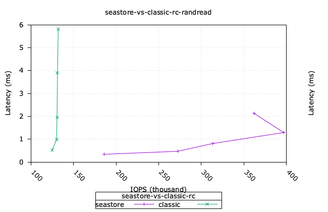

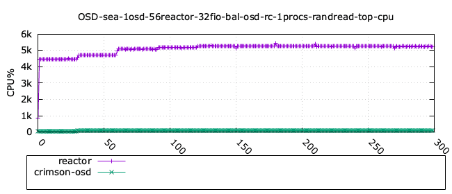

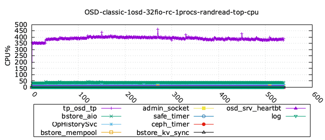

Randread 4k ¶
Seastore clearly shows a significant performance improvement over Classic for this workload, with a maximum throughput of 400K IOPS vs 130K IOPS, respectively.
Click to see the CPU utilisation.
| Classic | Seastore |
- Note: we do not show the memory utilisation in the charts since its mostly remains constant, and does not add much to the analysis. - In the following tables we show the detailed measurements for each workload. All the column names in lower case are provided from the benchmark FIO, whereas the only two columns in Uppercase were measured using - topcommand, namely the OSD CPU and OSD memory utilisation.
Classic OSD - rand4read k - detailed stats ¶
| iodepth | iops | total_ios | clat_ms | clat_stdev | usr_cpu | sys_cpu | OSD_cpu | OSD_mem |
| 1 | 108365.87 | 32509868.00 | 0.29 | 0.11 | 1.41 | 1.26 | 353.20 | 53.66 |
| 2 | 124779.61 | 37434134.00 | 0.51 | 0.31 | 1.55 | 1.40 | 426.76 | 66.35 |
| 4 | 130072.33 | 39022090.00 | 0.98 | 0.86 | 1.59 | 1.44 | 440.62 | 66.60 |
| 8 | 130657.61 | 39197807.00 | 1.96 | 2.59 | 1.56 | 1.43 | 442.40 | 66.60 |
| 16 | 131217.62 | 39366729.00 | 3.90 | 8.30 | 1.40 | 1.36 | 437.58 | 66.60 |
| 24 | 132017.46 | 39607879.00 | 5.81 | 18.94 | 1.30 | 1.30 | 429.83 | 66.60 |
| 32 | 131567.99 | 39477765.00 | 6.81 | 27.08 | 1.37 | 1.42 | 418.12 | 66.60 |
| 40 | 134032.49 | 40220335.00 | 6.22 | 26.81 | 1.78 | 1.87 | 416.35 | 66.60 |
| 52 | 135246.36 | 40576206.00 | 5.34 | 24.46 | 2.57 | 2.71 | 414.86 | 66.60 |
| 64 | 136637.79 | 40993659.00 | 4.85 | 23.90 | 3.32 | 3.44 | 408.23 | 66.60 |
Seastore OSD - randread 4k - detailed stats ¶
| 1 | 126108.05 | 37832541.00 | 0.25 | 0.07 | 1.75 | 1.62 | 4259.31 | 3479.04 |
| 2 | 186270.38 | 55881299.00 | 0.34 | 0.13 | 2.50 | 2.34 | 4792.02 | 3628.80 |
| 4 | 272327.60 | 81698825.00 | 0.47 | 0.20 | 3.56 | 3.18 | 5148.66 | 3628.80 |
| 8 | 313378.57 | 94014512.00 | 0.81 | 0.47 | 3.56 | 2.97 | 5258.81 | 3628.80 |
| 16 | 396901.06 | 119071509.00 | 1.29 | 0.89 | 4.36 | 3.18 | 5365.52 | 3628.80 |
| 24 | 362284.30 | 108688913.00 | 2.12 | 4.81 | 3.67 | 2.75 | 5362.52 | 3639.44 |
| 32 | 387618.69 | 116296461.00 | 2.64 | 14.40 | 4.36 | 3.23 | 5368.53 | 3645.60 |
| 40 | 346395.63 | 103929773.00 | 3.69 | 18.48 | 3.65 | 2.73 | 5354.85 | 3645.60 |
| 52 | 371220.47 | 111386558.00 | 4.48 | 33.79 | 4.24 | 3.11 | 5349.68 | 3645.60 |
| 64 | 328832.78 | 98673511.00 | 6.23 | 50.75 | 3.51 | 2.69 | 5328.60 | 3645.60 |

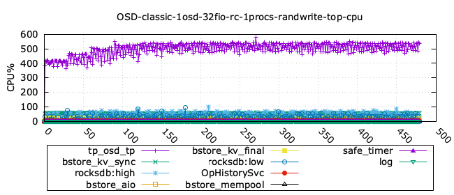

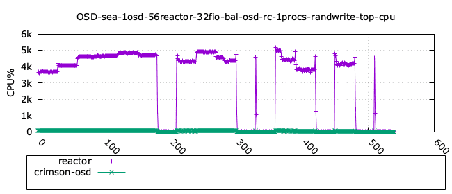

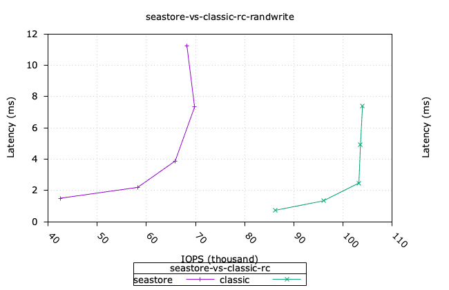

Randwrite 4k ¶
There is clear opportunity to improve the performance of Seastore for this workload. This is a very active area of work, led by Samuel Just, involving a number of optimisations for Seastore.
Classic OSD - randwrite 4k - detailed stats ¶
| 1 | 65903.70 | 19771176.00 | 0.48 | 1.00 | 1.36 | 1.01 | 781.41 | 75.73 |
| 2 | 86286.07 | 25885995.00 | 0.73 | 0.52 | 2.03 | 1.50 | 993.70 | 57.47 |
| 4 | 96025.22 | 28807854.00 | 1.33 | 0.70 | 2.51 | 1.91 | 1094.53 | 74.25 |
| 8 | 103263.42 | 30979542.00 | 2.47 | 1.03 | 3.34 | 2.57 | 1158.53 | 76.47 |
| 16 | 103583.23 | 31075901.00 | 4.94 | 5.42 | 2.23 | 1.30 | 1158.31 | 76.22 |
| 24 | 103991.81 | 31199311.00 | 7.38 | 10.90 | 1.99 | 1.09 | 1143.36 | 75.73 |
| 32 | 104675.98 | 31405724.00 | 9.78 | 17.08 | 1.86 | 0.98 | 1145.61 | 75.73 |
| 40 | 104459.77 | 31342317.00 | 12.25 | 23.81 | 1.81 | 0.89 | 1144.96 | 76.47 |
| 52 | 104192.40 | 31264494.00 | 15.97 | 34.90 | 1.72 | 0.82 | 1142.14 | 75.97 |
| 64 | 104833.30 | 31463618.00 | 19.53 | 47.70 | 1.64 | 0.79 | 1137.10 | 76.22 |
Seastore OSD - randwrite 4k - detailed stats ¶
| 1 | 31367.49 | 9410655.00 | 1.01 | 2.37 | 0.62 | 0.49 | 3648.14 | 3941.28 |
| 2 | 42493.17 | 12748376.00 | 1.50 | 3.97 | 0.75 | 0.59 | 4160.04 | 5390.00 |
| 4 | 58204.73 | 17461826.00 | 2.19 | 3.76 | 0.95 | 0.73 | 4680.48 | 6027.28 |
| 8 | 65861.89 | 19759489.00 | 3.88 | 5.34 | 1.06 | 0.79 | 4748.00 | 6194.16 |
| 16 | 69801.80 | 20942843.00 | 7.33 | 29.56 | 1.11 | 0.81 | 4928.67 | 6199.20 |
| 24 | 68240.35 | 20477292.00 | 11.25 | 46.16 | 1.11 | 0.79 | 4815.88 | 6199.20 |
| 32 | 71570.20 | 21477716.00 | 14.31 | 60.14 | 1.16 | 0.82 | 390.35 | 6199.20 |
| 40 | 10710.19 | 3363.00 | 354.63 | 691.85 | 0.08 | 0.07 | 4281.69 | 6199.20 |
| 52 | 16412.43 | 5810.00 | 160.41 | 334.38 | 0.25 | 0.17 | 4969.02 | 6199.20 |
| 64 | 7648.09 | 2608.00 | 394.05 | 527.43 | 0.08 | 0.16 | 4545.87 | 6199.20 |

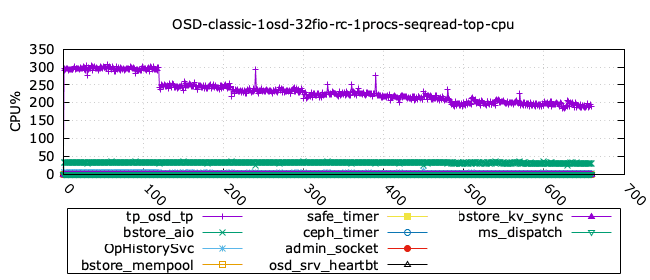

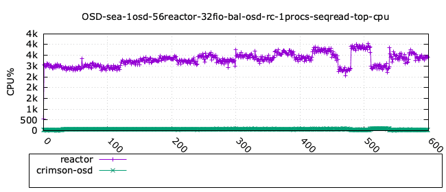

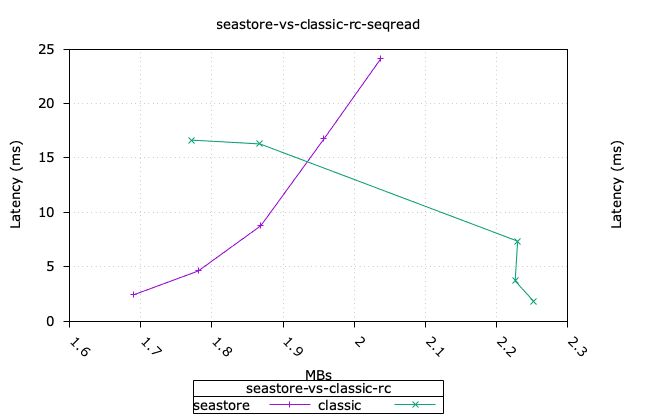

Seqread 64k ¶
Notice that the performance of Seastore is less than 10% lower than Classic for this workload, for practical purposes they can be considered the same.
Classic OSD - seqread 64k - detailed stats ¶
| iodepth | bw | total_ios | clat_ms | clat_stdev | usr_cpu | sys_cpu | OSD_cpu | OSD_mem |
| 1 | 2259.54 | 10591650.00 | 0.90 | 0.45 | 0.49 | 0.44 | 244.69 | 78.03 |
| 2 | 2252.25 | 10557518.00 | 1.82 | 1.16 | 0.47 | 0.43 | 264.26 | 80.91 |
| 4 | 2226.41 | 10436444.00 | 3.68 | 2.35 | 0.46 | 0.43 | 260.60 | 79.92 |
| 8 | 2229.90 | 10453186.00 | 7.34 | 4.71 | 0.45 | 0.43 | 258.87 | 79.67 |
| 16 | 1867.48 | 8754162.00 | 16.28 | 26.08 | 0.40 | 0.40 | 226.63 | 78.19 |
| 24 | 1771.64 | 8304783.00 | 16.63 | 30.38 | 0.53 | 0.59 | 224.78 | 78.19 |
| 32 | 1686.78 | 7906337.00 | 15.32 | 24.54 | 0.72 | 0.84 | 226.87 | 78.44 |
| 40 | 1620.78 | 7597046.00 | 15.36 | 30.58 | 0.84 | 1.03 | 215.50 | 79.18 |
| 52 | 1537.75 | 7207264.00 | 15.81 | 40.05 | 0.96 | 1.27 | 213.59 | 79.18 |
| 64 | 1457.19 | 6829824.00 | 14.76 | 46.98 | 1.21 | 1.59 | 215.77 | 77.95 |
Seastore OSD - seqread 64k - detailed stats ¶
| 1 | 1473.66 | 6907887.00 | 1.38 | 0.78 | 0.42 | 0.38 | 2849.74 | 5953.20 |
| 2 | 1690.21 | 7923018.00 | 2.42 | 1.61 | 0.44 | 0.41 | 2957.45 | 6199.20 |
| 4 | 1780.62 | 8346807.00 | 4.60 | 3.25 | 0.45 | 0.43 | 3092.81 | 6199.20 |
| 8 | 1868.70 | 8759887.00 | 8.76 | 7.66 | 0.46 | 0.43 | 2992.76 | 6199.20 |
| 16 | 1957.45 | 9176207.00 | 16.74 | 15.61 | 0.48 | 0.44 | 3235.70 | 6199.20 |
| 24 | 2037.46 | 9552208.00 | 24.12 | 26.46 | 0.47 | 0.46 | 3335.78 | 6199.20 |
| 32 | 2130.58 | 9988723.00 | 30.76 | 35.76 | 0.49 | 0.48 | 3437.99 | 6199.20 |
| 40 | 2181.19 | 10227339.00 | 37.55 | 49.96 | 0.49 | 0.48 | 3284.56 | 6199.20 |
| 52 | 2293.93 | 10757006.00 | 46.42 | 59.17 | 0.52 | 0.50 | 3502.08 | 6199.20 |
| 64 | 2241.97 | 10514348.00 | 42.65 | 61.72 | 0.63 | 0.65 | 3315.77 | 6199.20 |

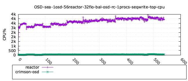

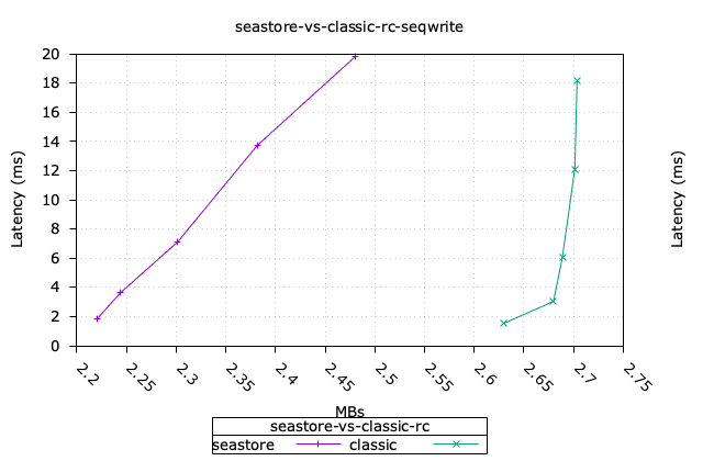

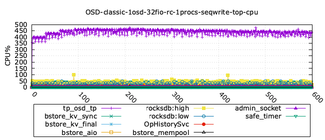

Seqwrite 64k ¶
Similarly as the previous workload, the performance of Seastore is within 10% than Classic, and hence can be considered the same.
Classic OSD - seqwrite 64k - detailed stats ¶
| 1 | 2413.60 | 11313833.00 | 0.83 | 0.36 | 1.90 | 0.65 | 597.74 | 40.63 |
| 2 | 2629.75 | 12326994.00 | 1.54 | 0.55 | 2.02 | 0.75 | 684.49 | 48.59 |
| 4 | 2679.76 | 12561442.00 | 3.04 | 1.28 | 1.95 | 0.69 | 698.03 | 55.99 |
| 8 | 2688.72 | 12603496.00 | 6.08 | 3.87 | 1.99 | 0.51 | 716.50 | 60.68 |
| 16 | 2701.16 | 12661982.00 | 12.11 | 15.45 | 2.33 | 0.43 | 697.26 | 61.17 |
| 24 | 2703.43 | 12673303.00 | 18.17 | 34.59 | 2.48 | 0.41 | 682.33 | 61.91 |
| 32 | 2596.58 | 12173046.00 | 24.76 | 57.19 | 2.54 | 0.41 | 679.37 | 61.91 |
| 40 | 2672.83 | 12533910.00 | 23.34 | 55.86 | 3.29 | 0.49 | 674.92 | 61.91 |
| 52 | 2607.49 | 12226048.00 | 20.86 | 47.36 | 4.62 | 0.69 | 650.55 | 62.16 |
| 64 | 2655.01 | 12446451.00 | 19.10 | 42.89 | 6.06 | 0.88 | 639.84 | 61.67 |
Seastore OSD - seqwrite 64k - detailed stats ¶
| 1 | 1895.08 | 8883327.00 | 1.07 | 1.12 | 1.21 | 0.43 | 3177.55 | 6001.82 |
| 2 | 2220.36 | 10408096.00 | 1.83 | 1.97 | 1.29 | 0.48 | 3184.46 | 6249.60 |
| 4 | 2244.20 | 10519929.00 | 3.64 | 3.36 | 1.27 | 0.48 | 3345.72 | 6249.60 |
| 8 | 2301.54 | 10788847.00 | 7.11 | 6.38 | 1.53 | 0.49 | 3213.67 | 6249.60 |
| 16 | 2381.86 | 11165433.00 | 13.74 | 12.08 | 2.16 | 0.49 | 3493.73 | 6249.60 |
| 24 | 2479.99 | 11627449.00 | 19.80 | 20.33 | 2.43 | 0.50 | 3431.81 | 6249.60 |
| 32 | 1557.10 | 7299365.00 | 42.07 | 36.08 | 2.05 | 0.50 | 3732.99 | 6249.60 |
| 40 | 1521.37 | 7131945.00 | 53.83 | 49.44 | 2.03 | 0.48 | 3723.61 | 6249.60 |
| 52 | 1563.37 | 7328734.00 | 68.10 | 64.74 | 2.13 | 0.49 | 3810.17 | 6249.60 |
| 64 | 1571.50 | 7367144.00 | 70.18 | 71.46 | 2.52 | 0.58 | 3860.27 | 6249.60 |
