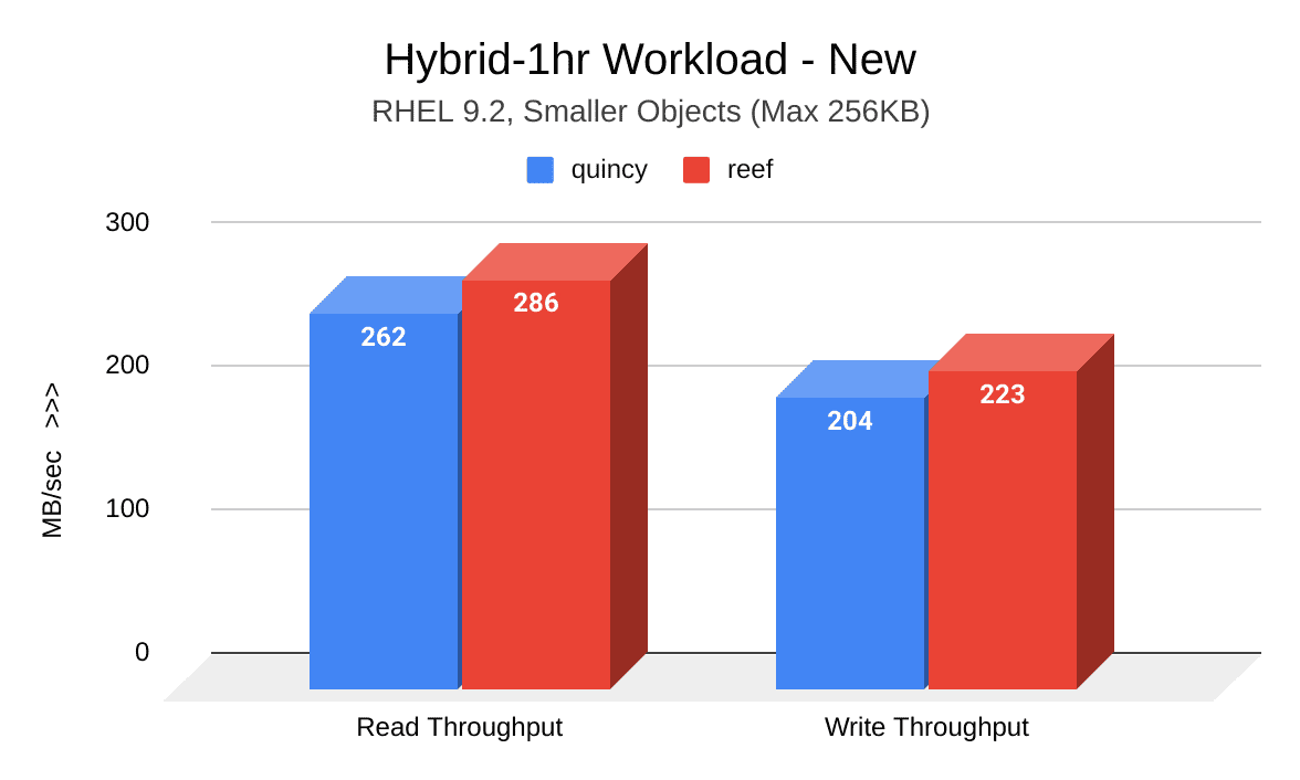

RGWtest - Small Object Sizing ¶
The cluster fill and aging workloads performed in this test cycle revealed significantly improved throughput results in Reef.
The following image shows a comparison of read and write throughput (MB/sec) between Quincy (blue) and Reef (red) when the cluster was new. Reef shows significant improvement:

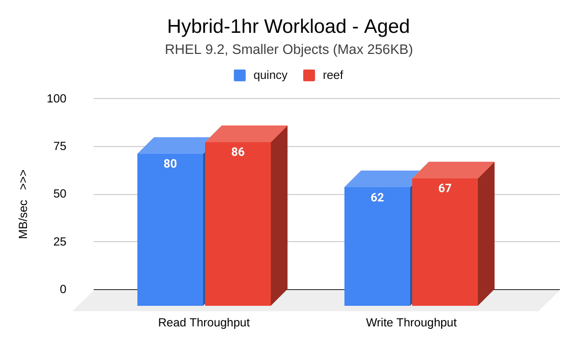

The following image shows a comparison of read and write throughput (MB/sec) between Quincy (blue) and Reef (red) after the cluster was aged. Reef shows significant improvement:

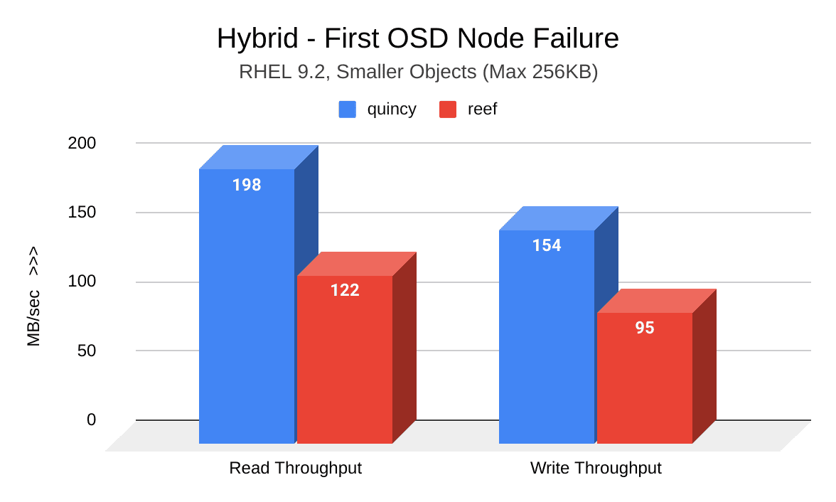

The following image shows a comparison of read and write throughput (MB/sec) between Quincy (blue) and Reef (red) after the first induced OSD node failure. Reef shows a decrease in throughput:

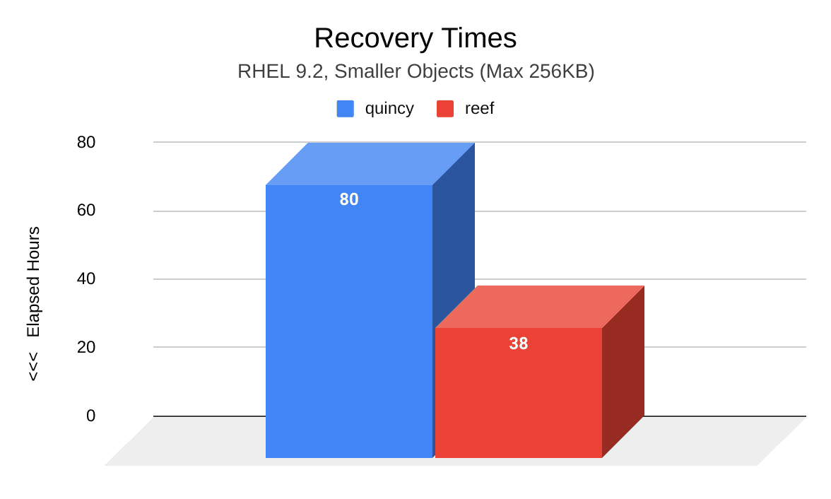

The following image shows a comparison of recovery time (hours) between Quincy (blue) and Reef (red) after two induced OSD node failures. Compared to Quincy, PGs in Reef took significantly less time to reach an active+clean state. At a total of 38 hours, Reef’s recovery time took 42 less hours than Quincy’s recovery time of 80 hours.

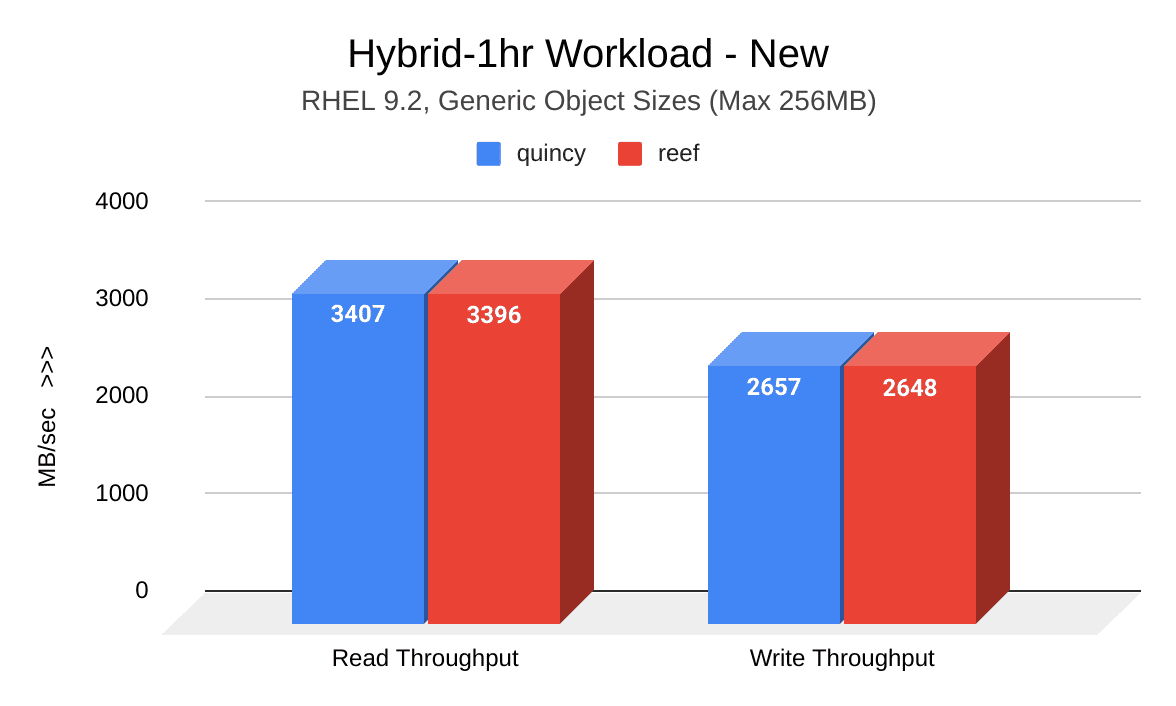

RGWtest Test Cycle - Generic Object Sizing ¶
The cluster fill and aging workloads performed in this test cycle also showed that Reef's throughput was as good, or slightly better, than Quincy's.
The following image shows a comparison of read and write throughput (MB/sec) between Quincy (blue) and Reef (red) when the cluster was new. Reef's results are comparable to Quincy's:

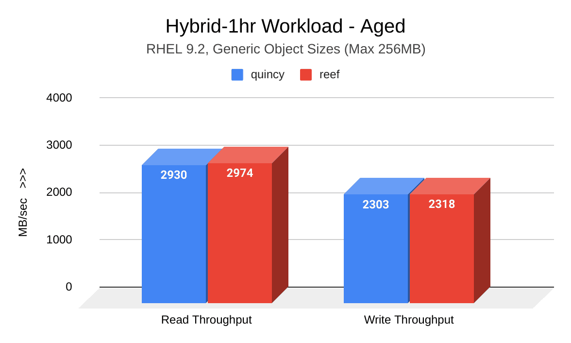

The following image shows a comparison of read and write throughput (MB/sec) between Quincy (blue) and Reef (red) after the cluster was aged. Reef shows a slight improvement:

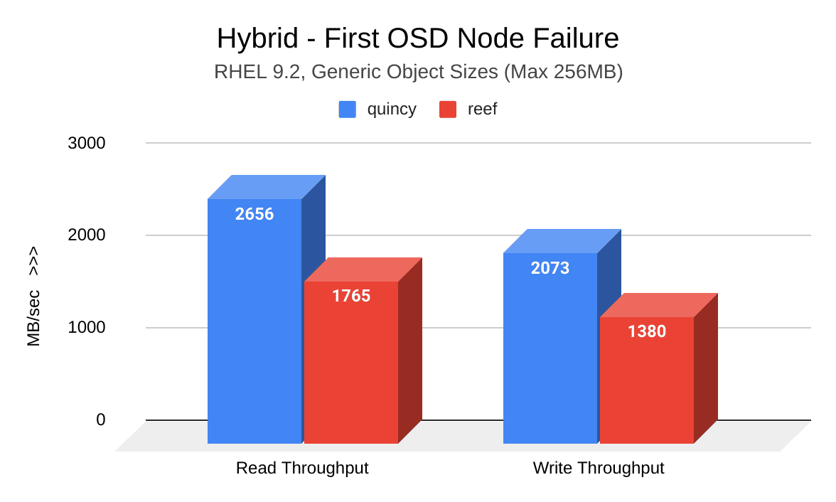

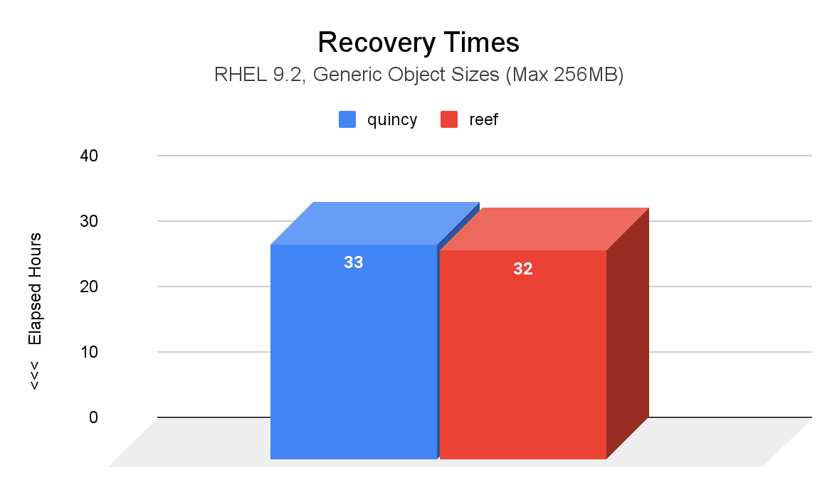

The following image shows a comparison of recovery time (hours) between Quincy (blue) and Reef (red) after two induced OSD node failures. Compared to Quincy, PGs in Reef took 1 hour less to reach an active+clean state.

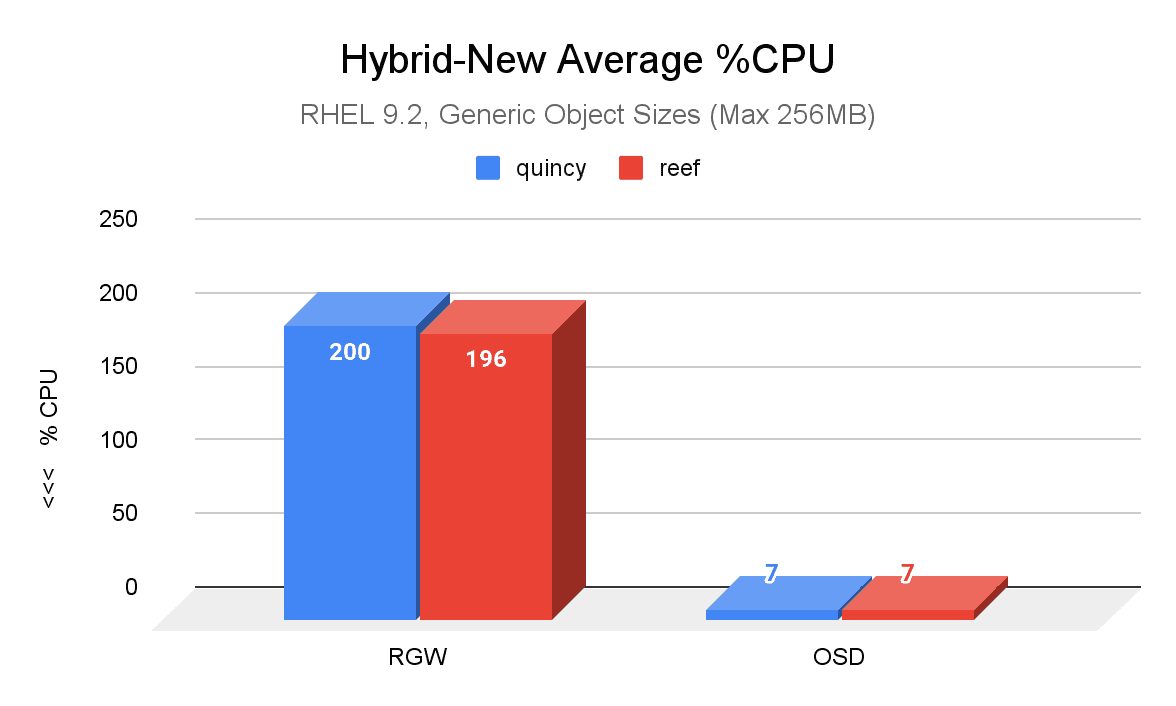

CPU utlilization was also measured during cluster fill and aging workloads, as well as during the OSD failure scenarios. These results proved to be comparable across releases for both small and generic object sizes.
The most notable difference is shown in the following image, which is a comparison of average percent CPU usage between Quincy (blue) and Reef (red) in a new cluster with generic object sizes. Reef’s RGW CPU usage showed a slight improvement compared to Quincy’s.
