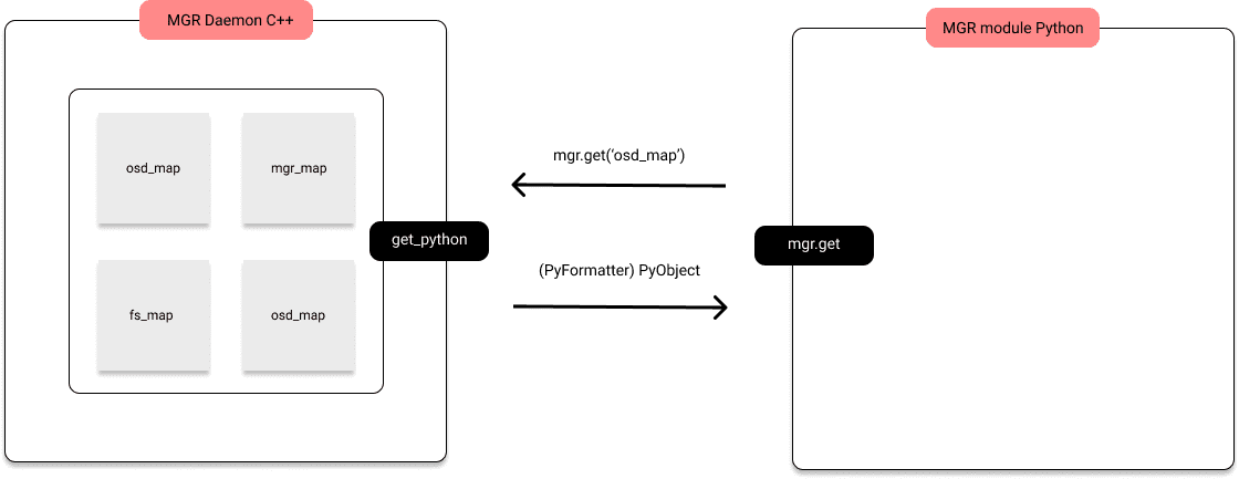

A grosso modo, mgr modules are connected like:
As you can see, the daemon holds most of the maps of the cluster. When something is requested, for example get('osd_map'), it will start to transform the OSDMap to a PyObject with what we call Formatters (PyFormatter in this instance). Caching a PyObject is difficult since we would have to make a copy for each python module so, we used a simpler approach where we would transform the structure to json (With JsonFormatter) where we only have to worry about serializing and deserializing.

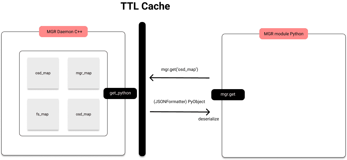

With json serialization in place, a shared TTL Cache between modules and the daemon was added:

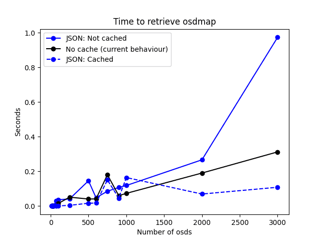

Not everything is cached as it might seem in the diagram but most of the problematic calls are. Serializing with JSON itself is not a great improvement but, if we cache the serialized object we see 2.8x improvement with 3000 osds.
In the following line chart a clear distinction is made between the current behaviour and the cache with json serialization. This benchmarks were run by requesting the OSDMap 5000 times for each number of osds. These are the results:
The blue dashed line represents the improvement in latency to retrieve and osdmap, the black line is the usual behaviour and the blue line, the results without caching json objects.

With a disabled cache the usual behaviour is still faster; nevertheless, we see a clear improvement of almost 3x on larger clusters with the cache enabled and using a simple serialization tool like json.
