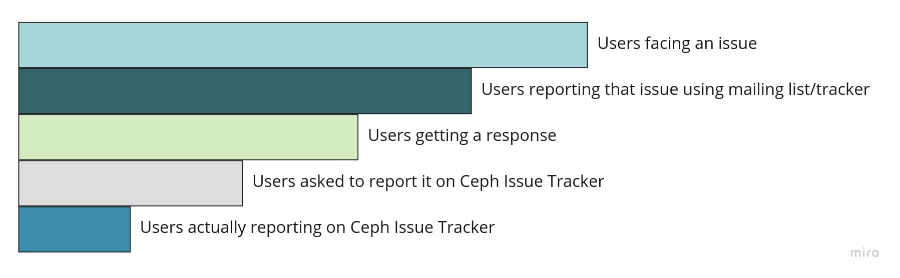

  2. Funnel decreases When a user encounters a problem he/she generally reaches out to the ceph user or developer mailing list to enquire about the same. Not all of the users get a reply back. Let's say out of 100 users reporting, only 75% get a reply back (Rough figures, only for explanation). Out of those 75 getting a reply, about 50 of them are asked to create a new issue on the Ceph Issue Tracker. Out of those asked to create an issue, not all of them end up visiting the Ceph Issue Tracker due to the inconvenience at every stage of this process. Thus the number of users reporting an issue, at last, is significantly small. We can understand this better using the below diagram:
Funnel Diagram

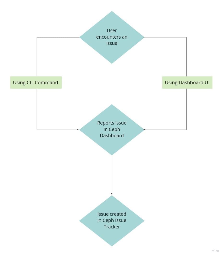

The solution we came up with was to integrate Ceph Issue Tracker with the Ceph Dashboard. Ceph Dashboard is the frontend component of the Ceph project. It can be used to monitor and update the services running in the Ceph environment.
The user should be able to report issues from the Ceph CLI as well as the Ceph Dashboard.
Ceph User Workflow

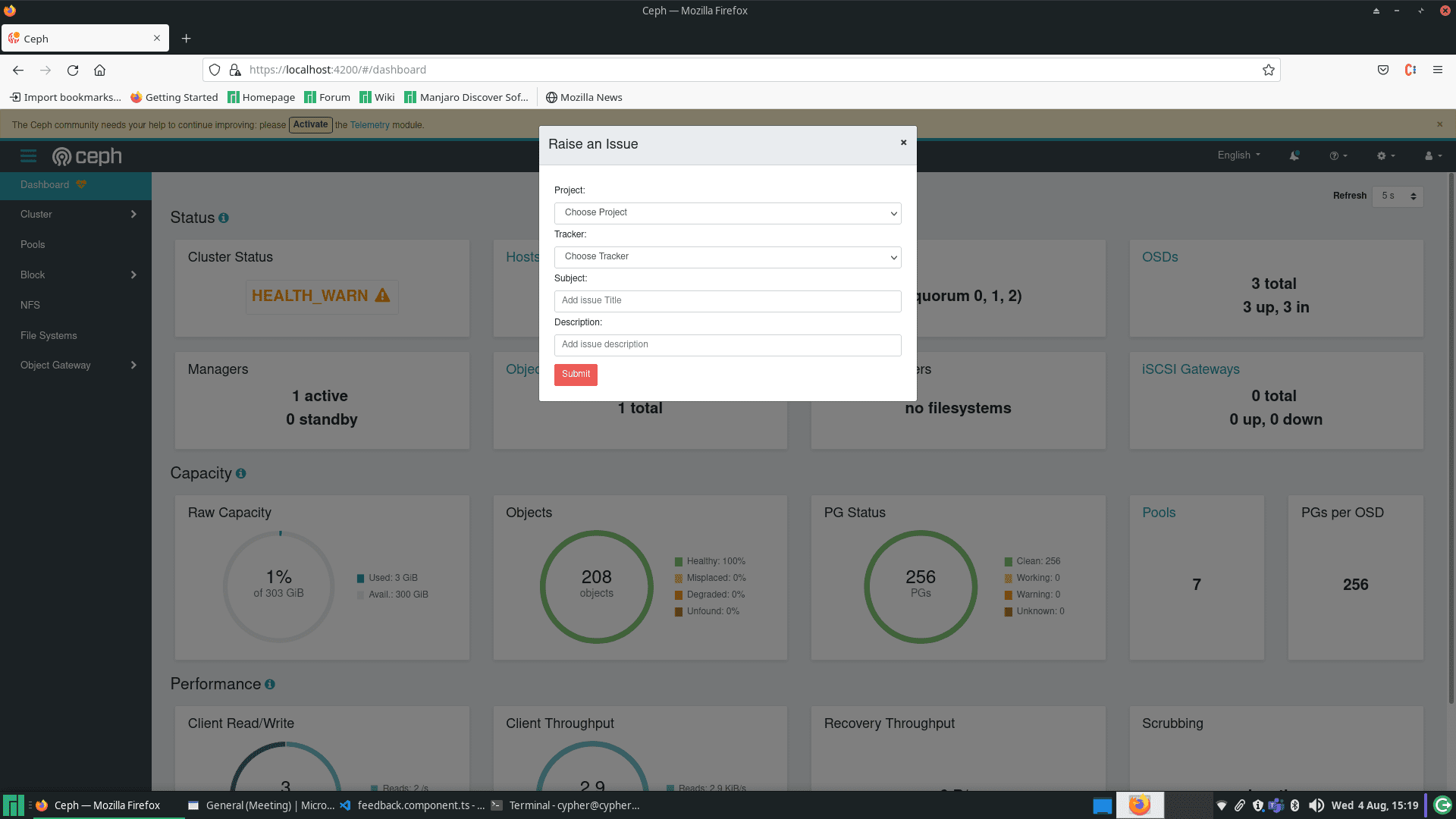

Using Dashboard
On clicking the settings icon at the top right of the window, in the navbar the user needs to click on raise an issue. This would open a modal that looks like:
Ceph Dashboard
The user has to choose the component and tracker from the list of respective drop down menus. Then they can enter the title and description of the issue. They can then proceed to create an issue in the ceph issue tracker. The modal that opens after that has the detail of the issue created and the option to redirect to the Ceph Issue tracker or stay on the current page.
