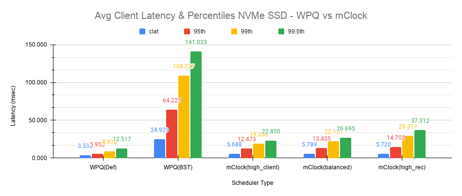

Client Latency Comparison ¶
Fig 2 shows the average completion latency (clat) along with the average 95th, 99th and 99.5th percentiles across the schedulers and their respective configurations.
Fig 2: Average Client Latency & Percentiles NVMe SSDs
The average clat latency obtained with WPQ(Def) was 3.535 msec. But in this case the number of concurrent recoveries was very much limited at an average of around 97 objects/sec or ~388 MiB/s and a major contributing factor to the low latency seen by the client.
With WPQ(BST) and with the non-default recovery options, things are very different with the average clat latency shooting up to an average of almost 25 msec which is 7x times worse! This is due to the high number of concurrent recoveries which was measured to be ~350 objects/sec or ~1.4 GiB/s which is close to the maximum OSD bandwidth.
With mClock enabled and with the default high_client_ops profile, the average clat latency was 5.688 msec which is impressive considering the high number of concurrent active background backfill/recoveries. The recovery rate was throttled down by mClock to an average of 80 objects/sec or ~320 MiB/s according to the minimum profile allocation of 25% of the maximum OSD bandwidth thus allowing the client operations to meet the QoS goal.
With the other profiles like balanced and high_recovery_ops, the average client clat latency didn’t change much and stayed between 5.7 - 5.8 msec with variations in the average percentile latency as observed from the chart above.

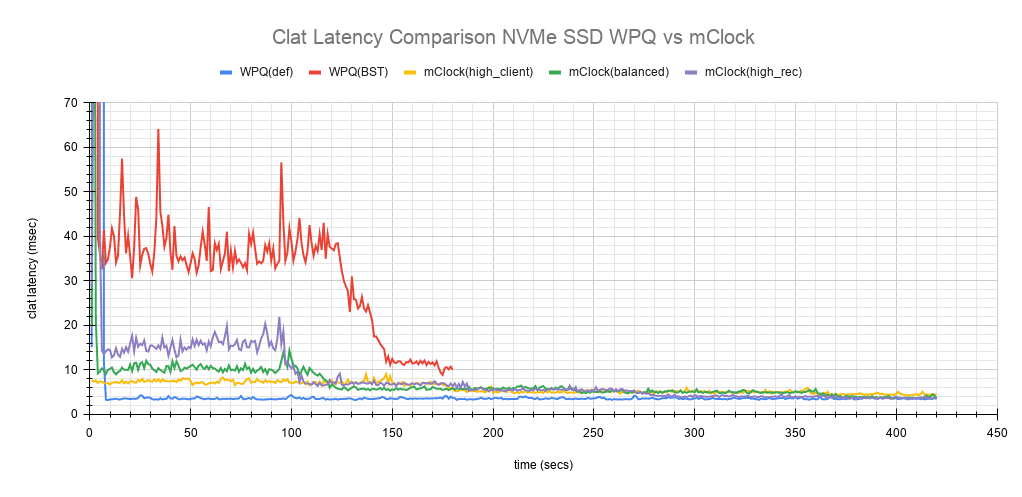

Fig 3: Clat Latency Comparison NVMe SSD
Perhaps a more interesting chart is the comparison chart shown in Fig 3 that tracks the average clat latency variations through the duration of the test. The chart shows the differences in the average latency between the WPQ and mClock profiles). During the initial phase of the test, for about 150 secs, the differences in the average latency between the WPQ scheduler and across the profiles of mClock scheduler are quite evident and self explanatory. The high_client_ops profile shows the lowest latency followed by balanced and high_recovery_ops profiles. The WPQ(BST) had the highest average latency through the course of the test.

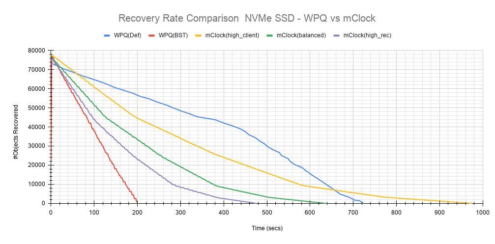

Another important aspect to consider is how the recovery bandwidth and recovery time are affected by mClock profile settings. Fig 4 outlines the recovery rates and times for each mClock profile and how they differ with the WPQ scheduler. The total number of objects to be recovered in all the cases was around 75000 objects as observed in the chart below.
Fig 4: Recovery Rate Comparison NVMe SSD
Intuitively, the high_client_ops should impact recovery operations the most and this is indeed the case as it took an average of 966 secs for the recovery to complete at 80 Objects/sec. The recovery bandwidth as expected was the lowest at an average of ~320 MiB/s.

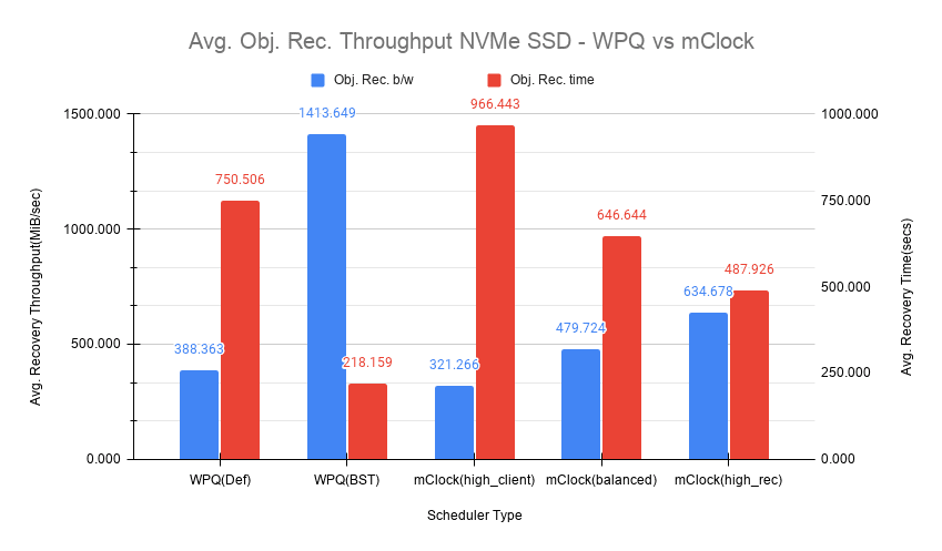

Fig 5: Average Recovery Throughput NVMe SSD
The balanced profile provides a good middle ground by allocating the same reservation and weight to client and recovery operations. The recovery rate curve falls between the high_recovery_ops and high_client_ops curves with an average bandwidth of ~480 MiB/s and taking an average of ~647 secs at ~120 Objects/sec to complete the recovery.
The high_recovery_ops profile provides the fastest way to complete recovery operations at the expense of other operations. The recovery bandwidth was nearly 2x the bandwidth at ~635 MiB/s when compared to the the bandwidth observed using the high_client_ops profile. The average object recovery rate was ~159 objects/sec and completed the fastest in approximately 488 secs.

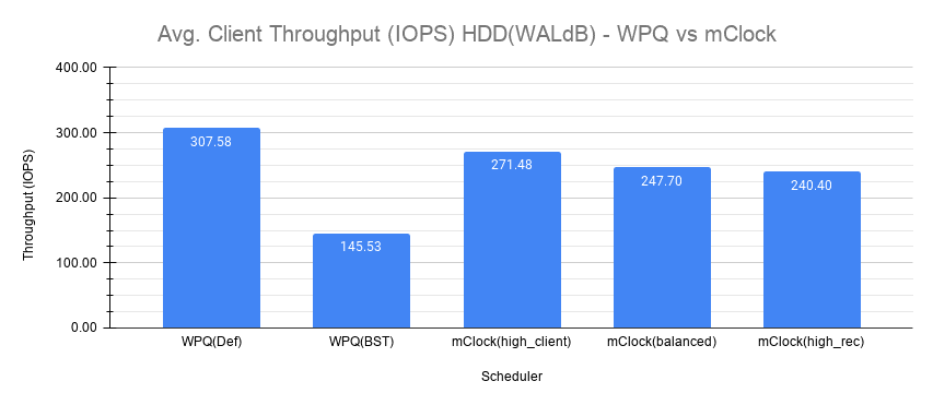

The average client throughput comparison and latency for WPQ and mClock and its profiles are shown in Fig 6 & 7.
Fig 6: Average Client Throughput HDD(WALdB)
With WPQ(Def), the average client throughput obtained was ~308 IOPS since the the number of concurrent recoveries was very much limited. The average clat latency was ~208 msec.
However for WPQ(BST), due to concurrent recoveries client throughput is affected significantly with 146 IOPS and an average clat latency of 433 msec.

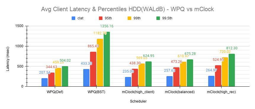

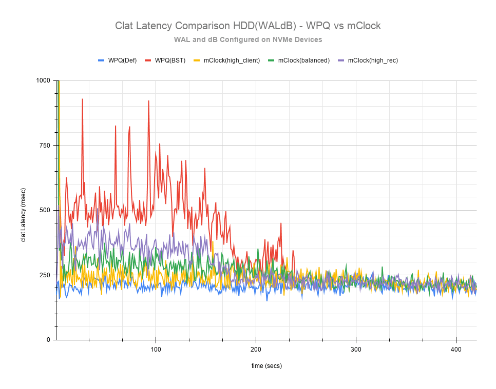

Fig 7: Average Clat Latency & Percentiles HDD(WALdB)
With the high_client_ops profile, mClock was able to meet the QoS requirement for client operations with an average throughput of 271 IOPS which is nearly 80% of the baseline throughput at an average clat latency of 235 msecs.
For balanced and high_recovery_ops profiles, the average client throughput came down marginally to ~248 IOPS and ~240 IOPS respectively. The average clat latency as expected increased to ~258 msec and ~265 msec respectively.
Fig 8: Clat Latency Comparison HDD(WALdB)
The clat latency comparison chart in Fig 8 provides a more comprehensive insight into the differences in latency through the course of the test. As observed with the NVMe SSD case, high_client_ops profile shows the lowest latency in the HDD case as well followed by the balanced and high_recovery_ops profile. It’s fairly easy to discern this between the profiles during the first 200 secs of the test.

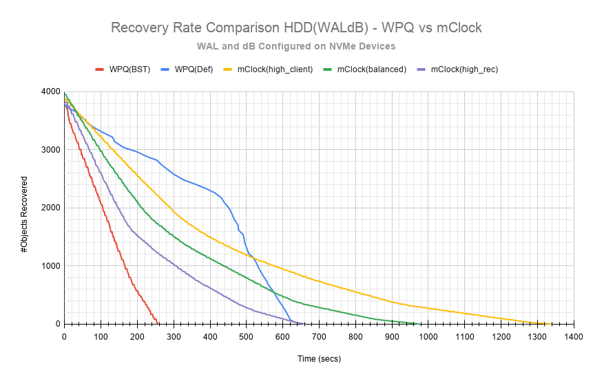

Recovery Statistics Comparison ¶
The charts in Fig 9 & 10 compares the recovery rates and times. The total number of objects to be recovered in all the cases using HDDs with WAL and dB was around 4000 objects as observed in the chart below.
Fig 9: Recovery Rate Comparison HDD(WALdB)
As expected, the high_client_ops impacts recovery operations the most as it took an average of ~1409 secs for the recovery to complete at ~3 Objects/sec. The recovery bandwidth as expected was the lowest at ~11 MiB/s.

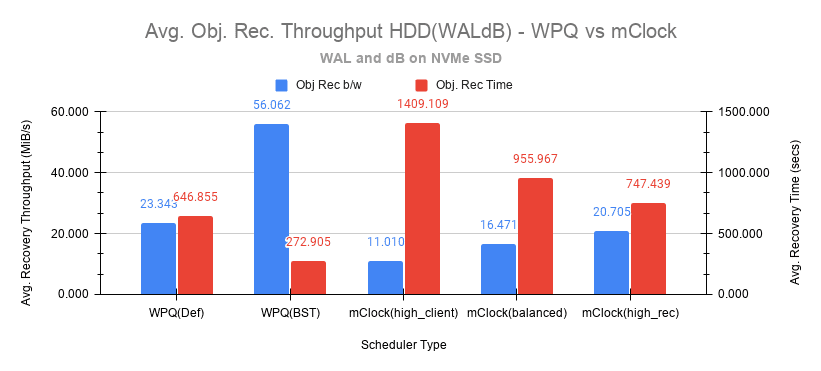

Fig 10: Average Recovery Throughput HDD(WALdB)
The balanced profile as expected provides a decent compromise with an an average bandwidth of ~16.5 MiB/s and taking an average of ~966 secs at ~4 Objects/sec to complete the recovery.
The high_recovery_ops profile is the fastest with nearly 2x the bandwidth at ~21 MiB/s when compared to the high_client_ops profile. The average object recovery rate was ~5 objects/sec and completed in approximately 747 secs. This is somewhat similar to the recovery time observed with WPQ(Def) at 647 secs with a bandwidth of 23 MiB/s and at a rate of 5.8 objects/sec.

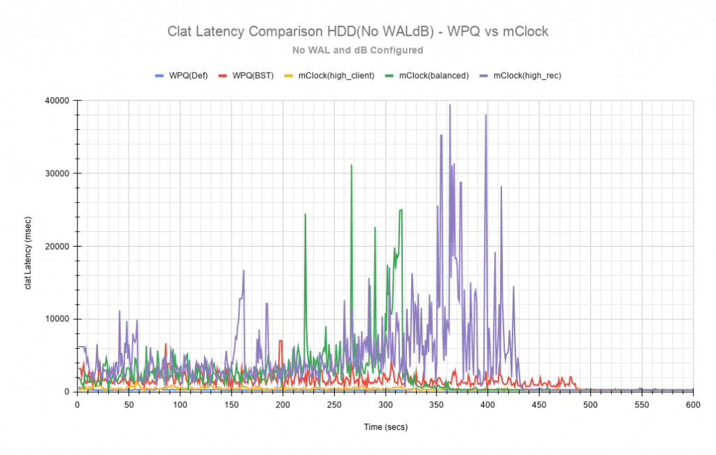

Test Results With HDDs (No WAL and dB configured) ¶
The recovery tests were also performed on HDDs without bluestore WAL and dB configured. The baseline throughput measured was 315 IOPS.
This type of configuration without WAL and dB configured is probably rare but testing was nevertheless performed to get a sense of how mClock performs under a very restrictive environment where the OSD capacity is at the lower end. The sections and charts below are very similar to the ones presented above and are provided here for reference.
Client Throughput & latency Comparison ¶

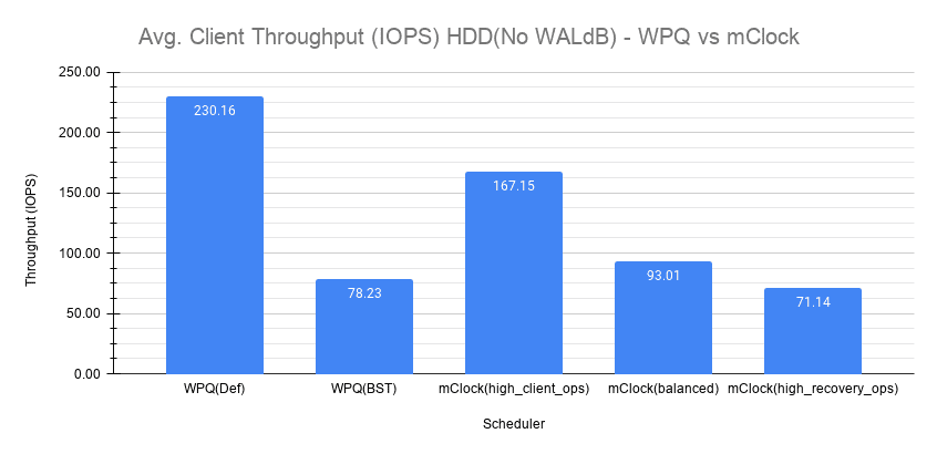

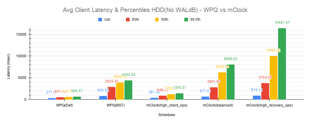

The average client throughput, latency and percentiles are compared as before in the set of charts shown below.
Fig 11: Average Client Throughput HDD(No WALdB)
Fig 12: Average Client Latency & Percentiles HDD(No WALdB)

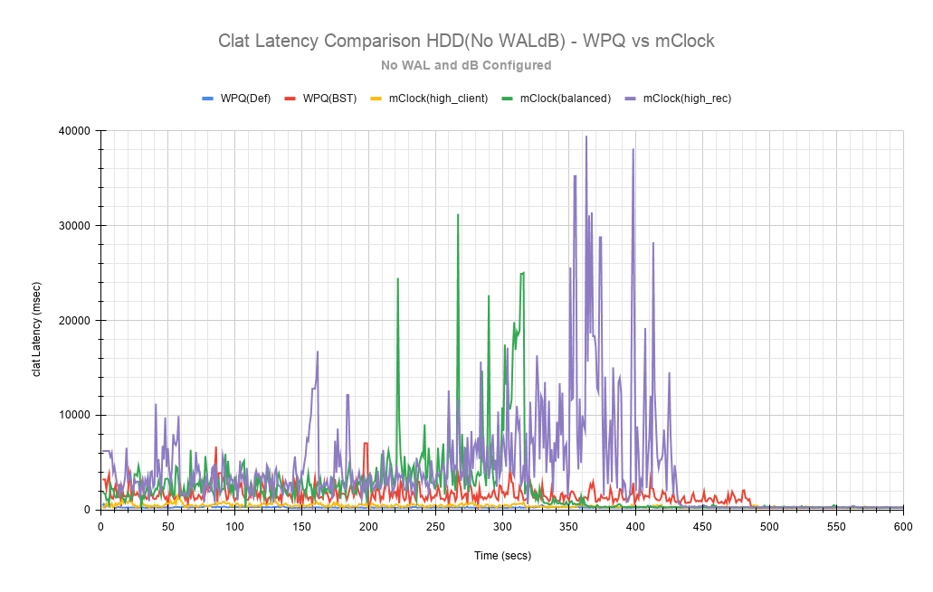

Fig 13: Clat Latency Comparison HDD(No WALdB)

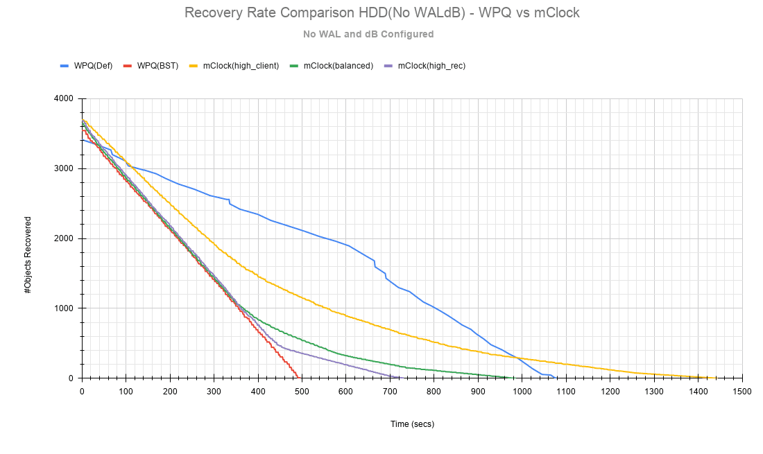

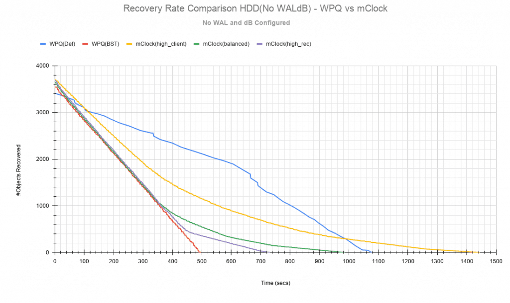

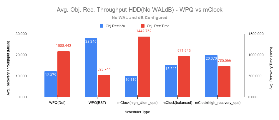

The recovery rates and times are shown in the charts below.
Fig 14: Average Object Recovery Throughput HDD(WALdB)
Fig 15: Recovery Rate Comparison HDD(No WALdB)
