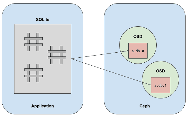

For Ceph, this glue library functions by translating reads, writes, and file locks to corresponding operations on a series of objects in Ceph’s RADOS. This mostly involves striping the SQLite database file over a number of objects in Ceph. (This is something we already regularly do in CephFS and RBD.)
