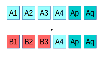

In the case of an erasure coded object, things are a bit more complicated. Instead of three identical and complete copies of the object, the content is spread over (in the above example) four objects, each with 1/4th of the data, and two erasure objects p and q. If there is failure mid-update and only three of the "A" objects are updated with the new "B" content, we have a problem: a 4+2 erasure code requires any 4 shards to reconstruct the original content, but we have only three of the new and three of the old, such that neither can be reconstructed. This basic problem is a generalized version of the so-called "RAID hole." Many systems (even ones used widely in production) sweep this problem under the rug, and most of the time they get away with it, usually because whoever submitted the write before the system crashed will still be there to submit it again and pave over the problem. We have never found this option acceptable.
In order to recover from such a situation, RADOS has to be able to roll the B1, B2, and B3 objects back to their prior state before the update in order to restore system consistency. For the existing erasure coded pools we did this by only allowing appends, which meant that we could roll back by truncating off the new content. Until now, however, maintaining rollback information for data overwrites was expensive to implement: we would need to read the old content, write it to a temporary location, then write the new content, and later (after we're sure all shards have applied the update) discard the temporary rollback data. With BlueStore, finally, we are free to implement the low-level primitives we need. In this case, BlueStore simply creates a logical reference to the old about-to-be-overwritten blocks on disk, logically overwrites it with the new data (writing the new content to a new location), and later discards the old reference. The end result is that after a failure, any partially applied updates can be rolled back so that the data stored in RADOS is always in a consistent state.
