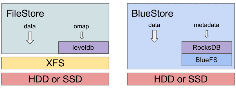

Ceph OSDs perform two main functions: replicating data across the network to other OSDs (along with the rebalancing, healing, and everything else that comes with that), and storing data on the locally attached device(s) (hard disk, SSD, or some combination of the two). The second local storage piece is currently handled by the existing FileStore module, which stores objects as files in an XFS file system. There is quite a bit of history as to how we ended up with the precise architecture and interfaces that we did, but the central challenge is that the OSD was built around transactional updates, and those are awkward and inefficient to implement properly on top of a standard file system.
In the end, we found there was nothing wrong with XFS; it was simply the wrong tool for the job. Looking at the FileStore design today, we find that most of its shortcomings are related to the hackery required to adapt our interface to POSIX and not problems with Ceph or XFS in isolation.

BlueStore is a clean implementation of our internal ObjectStore interface from first principles, motivated specifically by the workloads we expect. BlueStore is built on top of a raw underlying block device (or block devices). It embeds the RocksDB key/value database for managing its internal metadata. A small internal adapter component called BlueFS implements a file-system-like interface that provides just enough functionality to allow RocksDB to store its “files” and share the same raw device(s) with BlueStore.
