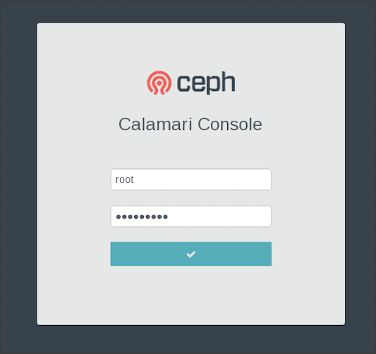

This username and password would be required to login to Calamari dashboard.

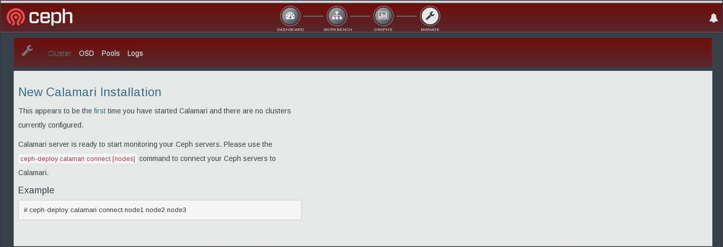

4. Openup browser and navigate to the IP address of your calamari server. You would see calamari dashboard login page , provide the login details that we have set in the last step.
5 Calamari would not be able to find the Ceph cluster and will ask to add a cluster , for this we need to add Ceph clients to dashboard by installing salt-minion and diamond packages on them.

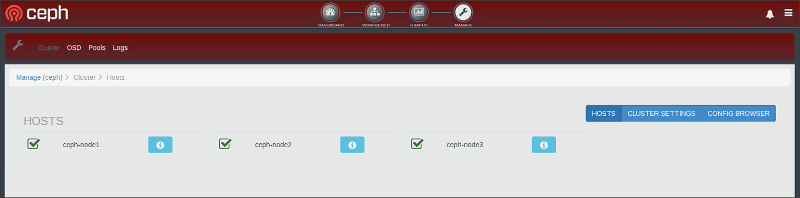

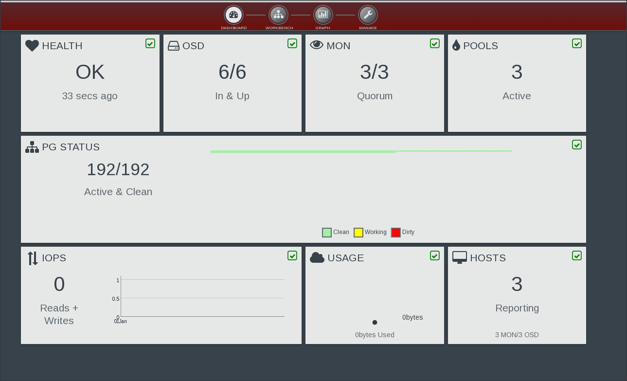

3. Finally check calamari dashboard , you should be able to view the Ceph cluster.
