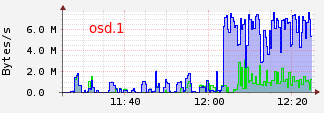

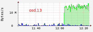

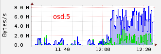

In this case, we can see that osd with id 13 has been added for this two placement groups. Pg 3.183 and 3.83 will respectively remove from osd 5 and 12. If we have a look on osd bandwidth, we can see those transfert osd.1 —> osd.13 and osd.5 —> osd.13 :
OSD 1 and 5 are primary for pg 3.183 and 3.83 (see acting table) and OSD 13 is writing.

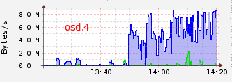

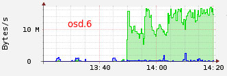

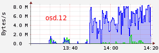

On the osd bandwidth, we can see those transfert osd.4 —> osd.6 and osd.12 —> osd.6 :
OSD 4 and 12 are primary for pg 3.143 and 3.ca (see acting table) and OSD 6 is writing. The OSD 7 will be released from both PG who will both be added to the OSD 6. In my case, the osd 7 has no reading because it is only as replica for both pgs.
